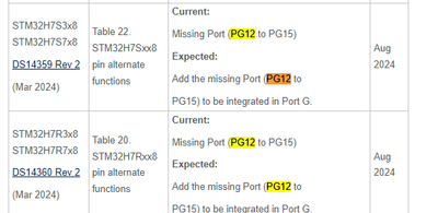

Missing info about PG12,PG13, PG14, PG15 alternate functions in Table 22 (datasheet DS14359 Rev 2). I hope that PG15 AF9 is PSSI_D13 like PG11.
2024-10-17 8:32 AM - edited 2024-10-18 12:52 AM
Thanks again for your contribution, the doc will be updated on the coming days with the complete AF for all Pins (due to the internal ticket number 183231). For now, what i can confirm to you is that the AF9 of PG15 is PSSI_D13 as you said before.
PS: this typo is already detected and published on the STM32 MCU datasheets: Expected preliminary updates - STMicroelectronics Community.
You can always check for expected updates on this article that is reviewed on a monthly basis.
Best Regards.
