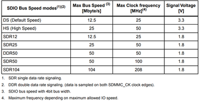

Look in rm of your cpu, sdmmc possible speed is written there . :)
Afaik all STM cpus need external driver for working on 1,8V on any of this hi-speed modes;
many of the more recent cpus can do this,
see here from H7A3 rm :
Without separate driver/level shifter only 3,3v modes possible.
