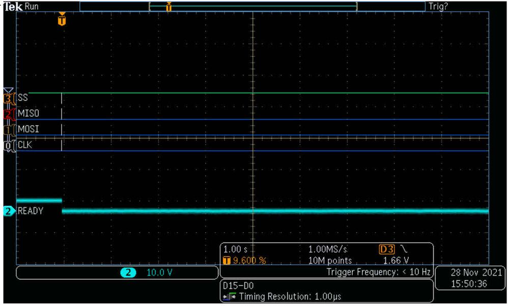

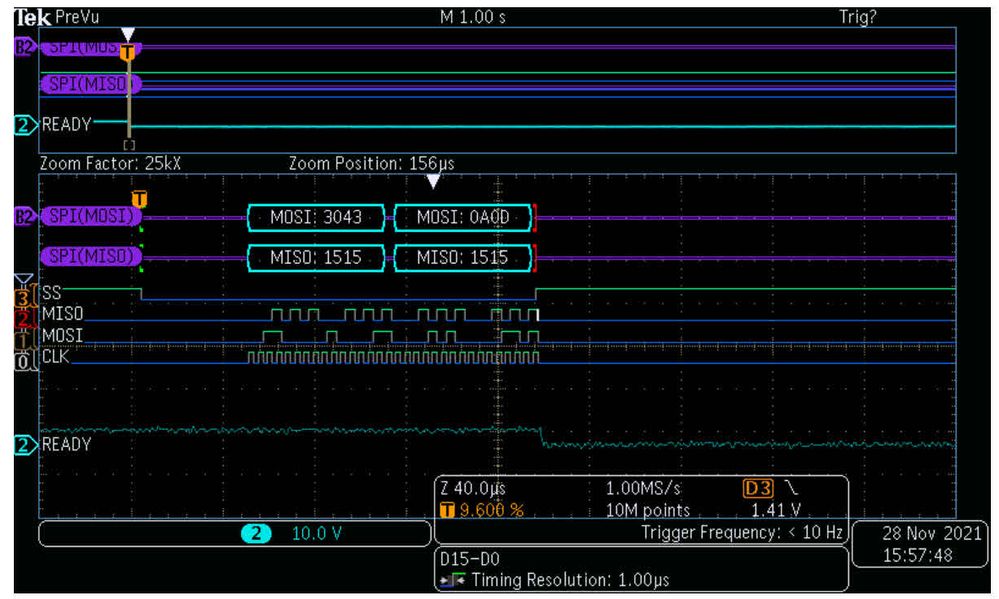

I can send the device AT commands and get back the OK response, but after setting the network parameters SSID, password, security mode, DHCP after issuing the Join Network command "C0" the module ready line goes low and never sets back to ready.
Overall Response of C0 Cmd
SPI Bus Detail of C0 Cmd

So I am confident the SPI bus is working OK
