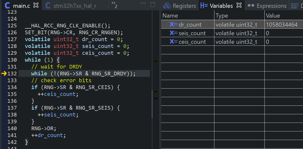

I made a test project similar to your code, but using interrupts as I am using interrupts in the Shortt clock project I am building. I don't thing using blocking or interrupts will make any difference to seed errors, but I wanted my test to be as close as possible to my application
Like you I got no errors. I used 64 bit counters to get more data, but still no errors.
The strange thing is I haven't had any more errors in my main project. I'm sure I wasn't imagining them as I put a breakpoints on the error code in the HAL RNG interrupt handler and the error happened twice.

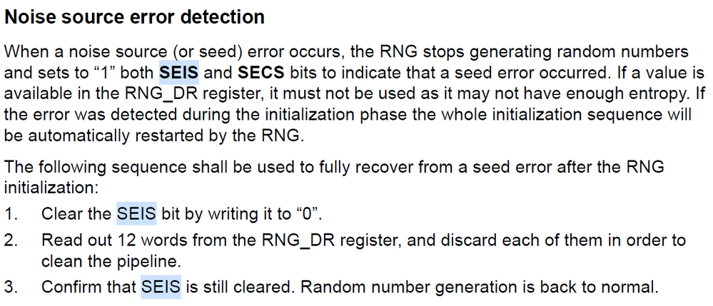

Seems like seed errors can occur and you need to monitor for them if you want the advertised randomness out of the peripheral. HAL does this for you. Seems like they should be incredibly infrequent, however, but definitely a finite probability.
The recovery sequence doesn't seem like it should take 200ms. But maybe it does.

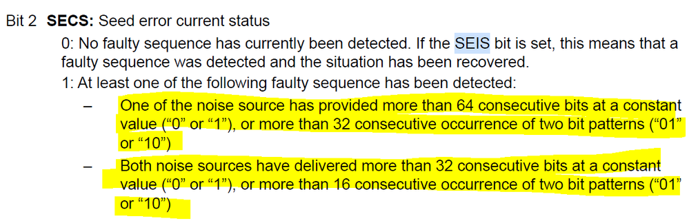

Doesn't sound right to me. If I read the reasons correctly, there are 16+4 reasons for the error, all with probability of 1/2^64, resulting probability is roughly 10^18. Assuming sampling in the order of 10s of MHz, the error should occur roughly once in 10^10 seconds, i.e. 300 years.
This and also the long recovery time - whatever it means and entails - indicates something wrong either in RNG setup or in the circumstances. The RNG in 'H7 is an overcomplicated beast and it appears that it contains numerous obscure ways to problems (e.g. "magic numbers").

The SEIS happens frequently enough that it made it both into the RM and the HAL library. The RM stating that you need to check it every time you read new data.

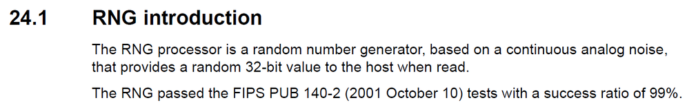

> ST claim that the RNG is a "True" random number generator and certainly imply the output is purely random not just the thermal noise source they use.
Where do they claim this?
Here's what they have to say in the F4 manual. It says nothing about a "true random." As the success ratio isn't 100%, presumably they're implying it is not perfect.

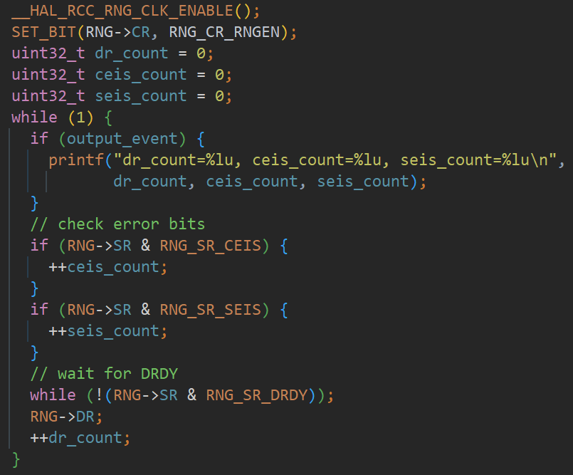

FWIW, I tested both an STM32F429 and an STM32H743 and couldn't get any error flags after hundreds of millions of samples, which is way less frequent than you're reporting. The RNG peripheral is different on the H7 compared to the F4. Note that the clock source feeding the RNG has some requirements, otherwise those flags will be tripped. Could be a clock thing.
H743:
F429:
[03:40.081125] dr_count=251392404, ceis_count=0, seis_count=0

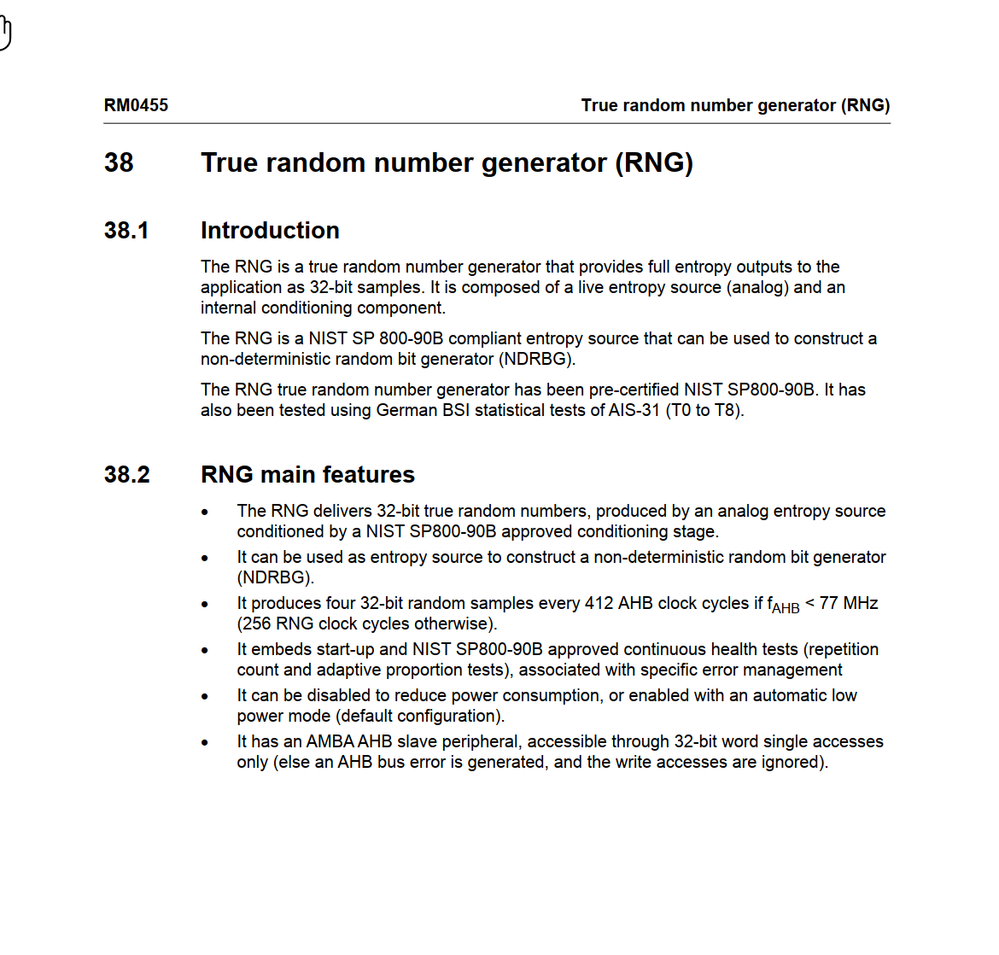

It is stated in RM0455 The Manual for the H7. I never mentioned an F4. The exact processor I am using is in the title of my post. I always put the part no of the processor in question in the title whenever it is relevant.
It seems pretty clear to me that they are claiming it is a "True" random number generator. I have raised a support ticket on this, hopefully they will explain it.

Hi TDK
Thanks for that.
I've been a way for a couple of days driving steam trains so I haven't got on to it yet. But I'll give your code a try and see what I get.
