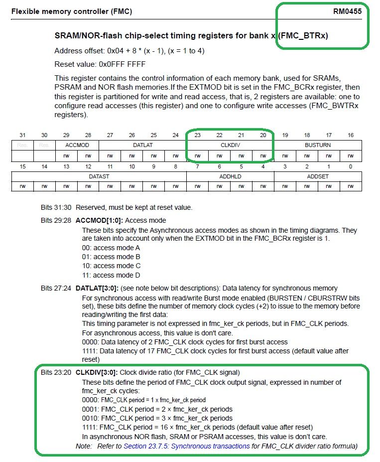

2022-07-21 6:20 AM
FMC_BTRx CLKDIV (x = BANK)
2022-07-21 6:40 AM
