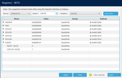

we are encountering difficulties in activating the compensation cell option. Even if the SYSCFG_CMPCR bit 0 has been configured as 1 we never get the READY in bit 8 (always 0).

Is SYSCFG clock set (RCC_APB2ENR.SYSCFGEN)?
Screenshot shows, that the SYSCFG_CMPCR register value is 0x101, i.e. bit 8 *is* set.
Screenshot also shows that debugger incorrectly displays *bit 7* as the READY bit.

Right, that's true. Thanks for reply. Then maybe there is an error on the STM32CubeProgrammer register maps?

To follow-up on this issue and avoid the confusion, an internal ticket is submitted (#190295).
