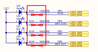

Hi @priya_12,
Can you please tell me which pin is not blinking?
And make sure that R202, R201, R200, and R199 for pins PK3, PK4, PK5, and PK6 are implemented and not removed.
Thank you.

2025-04-24 12:53 PM - edited 2025-04-24 12:55 PM
Hello @priya_12 ,
First, please kindly use </> button to paste a code. See this post. I've edited your post.
Second, to be efficient please attach your complete project including the ioc file.
What @ELABI.1 said is to check these resistors as it could someone else unsolder them:
But since all LEDs are on except LD3 you need to check the availability of R200.
