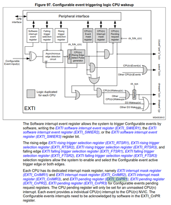

I did some digging, and I found in the RM0399 (page 800) this:
Based on the last paragraph, what i understand is that, each CPU will clear only its own PR, which makes sense by the time that each core has its own NVIC table. I don't think there is actually any race condition. And in my application, both mcus just change "state" and they are not involved by any means. Can you come up with a way that makes the system unsafe? Is there something I don't understand?
