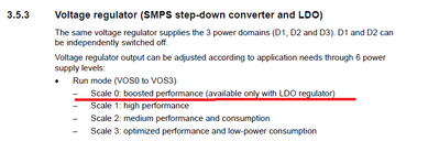

2024-11-02 5:50 AM
From your side please review your schematics and check if there is somethong wrong with SMPS HW by comparing it to NUCLEO-H755ZI schematics: https://www.st.com/resource/en/schematic_pack/mb1363-h755ziq-d01_schematic.pdf
And according to your code you are setting the SMPS and this configuration you cannot exceed 400MHz at VOS1.
From the datasheet:

@koyocik wrote:
Do you have any example which show how configure software to run with maximal clock 480MHz?
In SMPS configuration you can't reach that frequency. That's what I'm saying.
To reach 480MHz you need to be in LDO mode and your hardware needs to follow. Example: NUCLEO-H753 which is set in LDO config by HW.

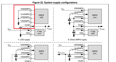

How should I connect pins 15 (VDDSD), 16 (VLXSD), 17 (VFBSD)?
2024-11-04 2:33 AM
This is how to connect SMPS pins when you are in LDO mode:
From Figure 22 / RM0399:
VDDSMPS: Connect to GND.
VLXSMPS: Leave unconnected (NC).
VFBSMPS: Connect to GND.
VSSSMPS: Connect to GND.
