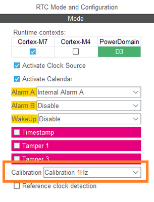

Please apologise me, maybe I'm mixing two things together which are not related. I just remember one my older issue with calibration output, when I start playing with RTC clock on STM32. When in MX Cube select calibration output 1Hz and then observe that there is no 1Hz. But It depends on correct value of async and sync prescallers. as noted in TRM manual. But now I don't play with calibration...

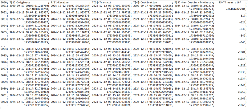

OK I see. And, just to be sure, the HSE_25MHz.txt file you've posted above are results taken *without* the feedback/correction, i.e. the time read out from RTC is only compared to NTP time, RTC is not set from NTP time (except for the first time), correct?
How do you read out the current time from RTC and convert it to milliseconds, exactly? What are the bus clocks frequencies in relationship to RTC clock frequency?
Could you try to use a higher divider (e.g. 50) to make sure the RTC clock is below 1MHz?

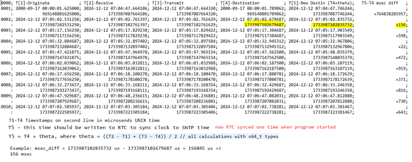

Thanks for theese suggestions,
Yeas exactly I do this way... but logs look quite different that for LSE (there was cumulative msec_diff)
So I tried to change 25 -> 50 divider PeriphClkInitStruct.RTCClockSelection = RCC_RTCCLKSOURCE_HSE_DIV50;
So now RTC clock input should be lowered to 500 kHz and with ASYNC = 49 and SYNC = 9999 prescallers I still get msec_diff 156; 598; 22; 472; 919; 371; 816; 730; 643; ... so it did not still helped:
Update: For comparsion when RTC is working from LSE with same prerequisites (only one time set RTC without SHIFTR correction) so first diff is 817msec. And in this option it works as expected.
But I must have working HSE :( So I will focus now why the msec_diff does not contain only increasing values. There must be something wrong there.
