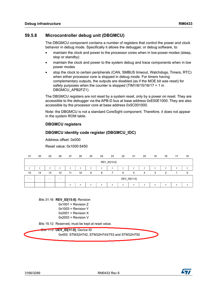

Do you know if it has the same chip id? I use HAL_GetREVID (DBGMCU->IDCODE) to distinguish between 400 and 480MHz parts
if(HAL_GetREVID()==0x1003)__HAL_PWR_VOLTAGESCALING_CONFIG(PWR_REGULATOR_VOLTAGE_SCALE1);
else __HAL_PWR_VOLTAGESCALING_CONFIG(PWR_REGULATOR_VOLTAGE_SCALE0);Thanks

Isn't that documented in the RM?
2020-05-08 6:00 AM
Yes, die and stepping information should be consistent.

"Isn't that documented in the RM?"
Yes if you know where to look and can find it - thanks
