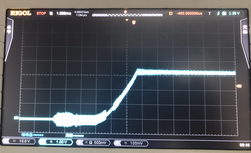

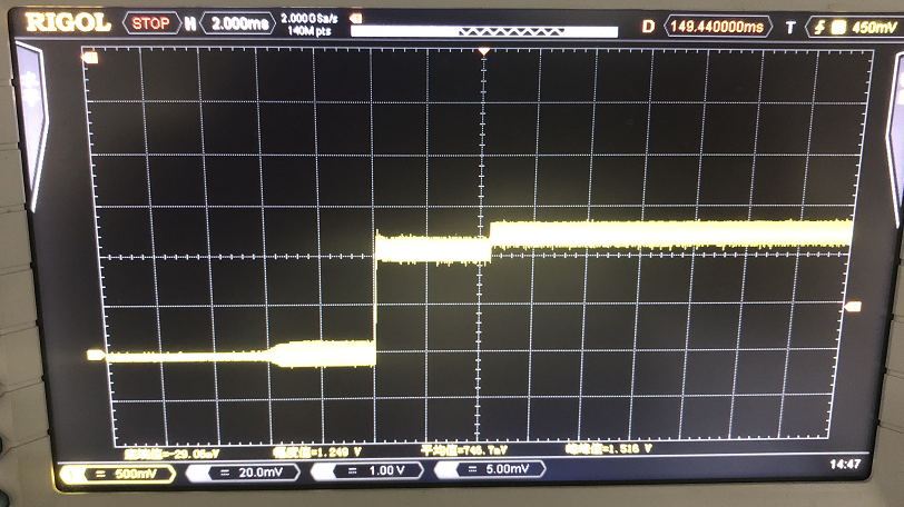

Some further details:
Figure 1. Vvcap rising edge
Figure 2. VDD3V3 rising edge
2018-11-02 5:17 AM
