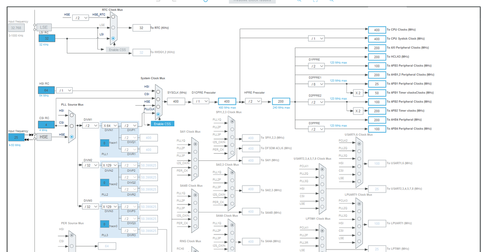

Hi friends.
I work with this chip STM32H753, but I set wrong clock.

}And my program stay here:
while (LL_RCC_GetSysClkSource() != LL_RCC_SYS_CLKSOURCE_STATUS_PLL1)
;Any idea, what is wrong?
