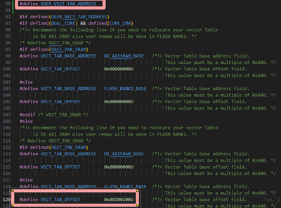

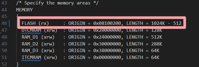

Currently, I'm testing the BDMA on SPI6 with the STM32H753. The SPI transmission works as expected when using the base flash address at 0x08000000. I need to place the application code at address 0x08100200. However, when I change the vector table offset and linker flash address to 0x08100200, the system enters an infinite loop whenever I transmit the buffer using BDMA SPI6

Change the vector offset and linker flash address to 0x08100200:
- Vector table offset and linker file settings:
- linker flash address:

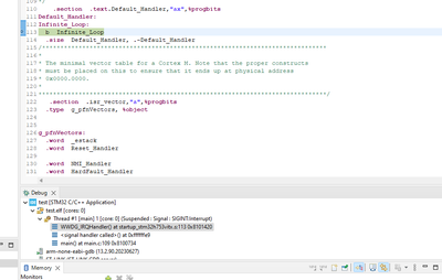

2024-07-18 1:45 AM
I think Window Watchdog interrupt is firing.
Please add WWDG_IRQHandler() in stm32h7xx_it.c and check if you reach the while loop in the WWDG IRQ:
void WWDG_IRQHandler(void)
while (1)
In that case did you enable the Window Watchdog in your code?
2024-07-18 9:33 PM
2024-07-18 10:01 PM
Thank you for getting back to me. I have changed the vector table offset to be a multiple of 1024, and it looks good to me.
