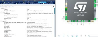

I am using stm32h750vbt6, does this mcu has center aligned mode in hrtim because i dont see any option in stm32cubemx for it.
2024-09-03 11:43 PM
Yes indeed, this feature is available for STM32G4 chip which contains an Hrtim version different from the one in h7.
Best regards.
