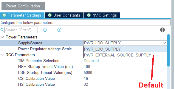

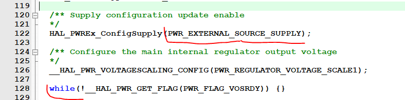

Thanks for your reply, I think I found the problem.
My project was built with earlier versions of Cubemx.
In the previous version with which I built my project, the default voltage supply required by the core was set with an external regulator.
But in the new cubemx, the default supply is with internal regulator.
For this reason, immediately after turning on the mcu during the execution of the rcc configuraion function, the power supply to the core was cut off and the mcu was not recognized by the stlink.
i measured vcap1 & vcap2 by multimeter and show zero.
I will test this change tomorrow and post the result here. Thanyou
2023-09-12 11:25 PM
I tested and my problem was solved by changing the core supply source to internal LDO.
