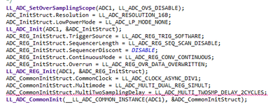

/** Common config
LL_ADC_SetOverSamplingScope(ADC1, LL_ADC_OVS_DISABLE);
ADC_InitStruct.Resolution = LL_ADC_RESOLUTION_16B;
ADC_InitStruct.LowPowerMode = LL_ADC_LP_MODE_NONE;
LL_ADC_Init(ADC1, &ADC_InitStruct);
ADC_REG_InitStruct.TriggerSource = LL_ADC_REG_TRIG_SOFTWARE;
ADC_REG_InitStruct.SequencerLength = LL_ADC_REG_SEQ_SCAN_DISABLE;
ADC_REG_InitStruct.SequencerDiscont = DISABLE;
ADC_REG_InitStruct.ContinuousMode = LL_ADC_REG_CONV_CONTINUOUS;
ADC_REG_InitStruct.Overrun = LL_ADC_REG_OVR_DATA_OVERWRITTEN;
LL_ADC_REG_Init(ADC1, &ADC_REG_InitStruct);
ADC_CommonInitStruct.CommonClock = LL_ADC_CLOCK_ASYNC_DIV1;
ADC_CommonInitStruct.Multimode = LL_ADC_MULTI_DUAL_REG_SIMULT;
ADC_CommonInitStruct.MultiTwoSamplingDelay= LL_ADC_MULTI_TWOSMP_DELAY_2CYCLES_5;
LL_ADC_CommonInit(__LL_ADC_COMMON_INSTANCE(ADC1), &ADC_CommonInitStruct);
