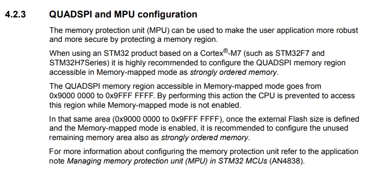

Hey together,
I have a question regarding MPU settings for an external QuadSPI Flash. We have a project where the full application code is placed onto the 4MB Quad SPI Flash memory W25Q32JVSIM. We have set up the QuadSPI in MemoryMapped moded and placed the application into the location 0x90000000. So far everything is fine and works as expected. Now we want to setup the MPU correct for this section. The only thing I found was in the document AN4760 on page 46. There is the follwoing indicated:
So I set up the region as follows:

HAL_MPU_ConfigRegion(&MPU_InitStruct);AN4760 on page 46:
They recommend to set it as strongly ordered memory which would be:

2021-08-11 9:46 AM
I think the first is a catch-all processed first (NO_ACCESS) to establish how the memory should be dealt with
I think you want caching, but not buffering or writing.
Most part you want full device accessible for XIP, one could perhaps partition in linker script to add some protection, but would need consistent application.
