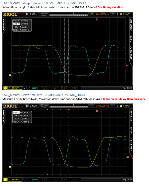

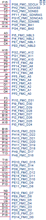

Working on a custom design using STM32H750 and 2 Winbond W989D6DBGX6E LPSDR memory devices configured for 32b bus.
The Design passes memory test at FMC_SDCLK@80Mhz.
The Design fails memory test at FMC_SDCLK@100Mhz.
When checking the signal timing, FMC_SDNWE was observed as marginal.
The design configured I/O High Speed Low voltage and I/O compensation.

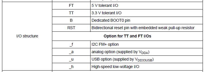

Checking the IO types for FMC_SDNWE io pins, the pin options DO NOT indicate the pin is _h type for High speed low voltage.
What would be the cause of the timing violation?

FMC_SDNWE total capacitance: 12pF total (PCB trace - 6pF + SDRAM 1 - 3pF + SDRAM 2 - 3pF)
FMC_SDCLK total capacitance: 12pF total (PCB trace - 6pF + SDRAM 1 - 3pF + SDRAM 2 - 3pF)

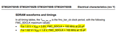

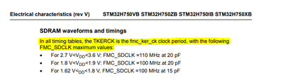

As mentioned in the datasheet, all timing tables are guaranteed for the following FMC_SDCLK maximum values and for capacity load condition:
• For 2.7 V<VDD<3.6 V: FMC_SDCLK =110 MHz at 20 pF
• For 1.8 V<VDD<1.9 V: FMC_SDCLK =100 MHz at 20 pF
• For 1.62 V<DD<1.8 V, FMC_SDCLK =100 MHz at 15 pF
May be this extra delay is due to capacity load.
