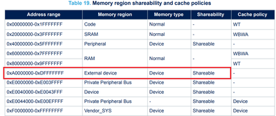

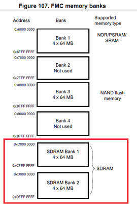

3- The SDRAM address region is located at 0xC000 0000 to 0xDFFF FFFF:
Which is a Non-cacheable region by default:
You said you configured the MPU, but did you set the SDRAM region as cacheable?

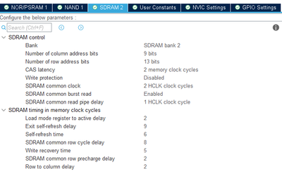

2- Did you set the same SDRAM timing for both?
yes. Here is the timing data.
// SDRAM clk = 100MHz, 10ns
// Exit Self-Refresh Delay, TXSR = 72ns, 8clk
// Self-Refresh Time, TRAS = 42ns, 5clk
// Common Row Cycle Delay, TRC = 60ns, 6clk
// Common Row Precharge Delay, TRP = 15ns, 2clk
// Row to Column Delay, TRCD = 15ns, 2clk
// Write Recovery Time, TWR = 2
// 8192 rows, refresh rate = 64ms/8192 = 7.81us
// refresh counter = (7.81 * 100) - 20 = 7613- The SDRAM address region is located at 0xC000 0000 to 0xDFFF FFFF:
I use SDRAM bank2 on STM32H5, I think the base address is 0xD000_0000.

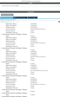

Here is the MPU_Config(), I referred AN4838 Table 9 to set MPU regions for internal SRAM, internal Flash, and Peripherals. MPU region 4 and MPU attribute 3 are used for SDRAM (0xD000_0000 to 0xD1FFF_FFFF). The region is set to instruction disable, inner-sharable, normal-cachable, write-back, transit, and rw-allocate.
void MPU_Config(void)
MPU_Region_InitTypeDef MPU_InitStruct = {0};
MPU_Attributes_InitTypeDef MPU_AttributesInit = {0};
/* Disables the MPU */
HAL_MPU_Disable();
/** Initializes and configures the Region 0 and the memory to be protected
MPU_InitStruct.Enable = MPU_REGION_ENABLE;
MPU_InitStruct.Number = MPU_REGION_NUMBER0;
MPU_InitStruct.BaseAddress = 0x20000000;
MPU_InitStruct.LimitAddress = 0x2009FFFF;
MPU_InitStruct.AttributesIndex = MPU_ATTRIBUTES_NUMBER0;
MPU_InitStruct.AccessPermission = MPU_REGION_ALL_RW;
MPU_InitStruct.DisableExec = MPU_INSTRUCTION_ACCESS_ENABLE;
MPU_InitStruct.IsShareable = MPU_ACCESS_NOT_SHAREABLE;
HAL_MPU_ConfigRegion(&MPU_InitStruct);
/** Initializes and configures the Region 1 and the memory to be protected
MPU_InitStruct.Number = MPU_REGION_NUMBER1;
MPU_InitStruct.BaseAddress = 0x08000000;
MPU_InitStruct.LimitAddress = 0x081FFFFF;
MPU_InitStruct.AttributesIndex = MPU_ATTRIBUTES_NUMBER1;
/** Initializes and configures the Region 2 and the memory to be protected
MPU_InitStruct.Number = MPU_REGION_NUMBER2;
MPU_InitStruct.BaseAddress = 0x40000000;
MPU_InitStruct.LimitAddress = 0x5FFFFFFF;
MPU_InitStruct.AttributesIndex = MPU_ATTRIBUTES_NUMBER2;
MPU_InitStruct.DisableExec = MPU_INSTRUCTION_ACCESS_DISABLE;
/** Initializes and configures the Region 3 and the memory to be protected
MPU_InitStruct.Number = MPU_REGION_NUMBER3;
MPU_InitStruct.BaseAddress = 0x80000000;
MPU_InitStruct.LimitAddress = 0x8FFFFFFF;
/** Initializes and configures the Region 4 and the memory to be protected
MPU_InitStruct.Number = MPU_REGION_NUMBER4;
MPU_InitStruct.BaseAddress = 0xD0000000;
MPU_InitStruct.LimitAddress = 0xD1FFFFFF;
MPU_InitStruct.AttributesIndex = MPU_ATTRIBUTES_NUMBER3;
MPU_InitStruct.IsShareable = MPU_ACCESS_INNER_SHAREABLE;
/** Initializes and configures the Region 7 and the memory to be protected
/** Initializes and configures the Attribute 0 and the memory to be protected
MPU_AttributesInit.Number = MPU_ATTRIBUTES_NUMBER0;
MPU_AttributesInit.Attributes = INNER_OUTER(MPU_NOT_CACHEABLE);
HAL_MPU_ConfigMemoryAttributes(&MPU_AttributesInit);
/** Initializes and configures the Attribute 1 and the memory to be protected
MPU_AttributesInit.Number = MPU_ATTRIBUTES_NUMBER1;
MPU_AttributesInit.Attributes = INNER_OUTER(MPU_WRITE_THROUGH|MPU_TRANSIENT
|MPU_NO_ALLOCATE);
/** Initializes and configures the Attribute 2 and the memory to be protected
MPU_AttributesInit.Number = MPU_ATTRIBUTES_NUMBER2;
MPU_AttributesInit.Attributes = MPU_DEVICE_nGnRE;
/** Initializes and configures the Attribute 3 and the memory to be protected
MPU_AttributesInit.Number = MPU_ATTRIBUTES_NUMBER3;
MPU_AttributesInit.Attributes = INNER_OUTER(MPU_WRITE_BACK|MPU_TRANSIENT
|MPU_RW_ALLOCATE);
/* Enables the MPU */
HAL_MPU_Enable(MPU_PRIVILEGED_DEFAULT);

1- For the performance comparison you need to set the system at the same config (compare like with like): same clock, same timings etc ..
2- As I can see, you didn't set the region 0xDxxx xxxx cacheable:
You didn't set the parameter MPU_AttributesInit.Attributes for that region to be cacheable and you didn't set it before. So 0xDxxx xxxx still not cacheable.

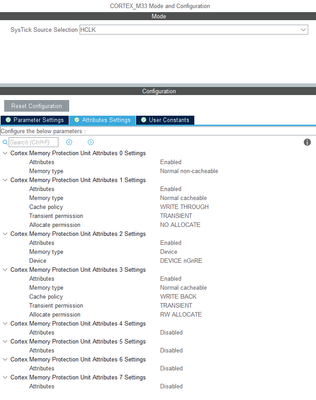

Thank you for quick reply.
(1) I mentioned H750 doesn't mean I want to obtain the same performance. What I confused is why I cannot get considerable SDRAM performance, no one will thought 11-20MB/s read/write performance while d-cache enabled is reasonable, especially for H-class MCU .
(2) MPU_Config() was generated byCubeMx. MPU_AttributesInit.Attributes was set from line 93 to 96.
The MPU_REGION_NUMBER4 has the MPU_ATTRIBUTES_NUMBER3, The MPU_ATTRIBUTES_NUMBER3 is set to "normal cacheable, write back, transit, and rw allocate", as the code indicated.
|MPU_RW_ALLOCATE);Do you mean MPU_ATTRIBUTES_NUMBER3 means no cacheable?
Or I should set MPU memory attributes beforce set MPU region? I think the order is irrelevant, just configure them before enable MPU is okay.
Could you please provide me with correct code to make SDRAM bank2 memory region cacheable?
2025-03-25 7:23 AM
I don't know how CubeMx generated that code but to me the region N3 was set after N4. So the attributes that was set to the region 3 was net set for the region 4.
So in your MPU region 4 config add manually the MPU attribute as for the region 3 and test.
