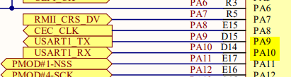

> I have my logic analyzer tapped into pins PB14/PB15
Looks like the VCP on the board is on PA9/PA10.
