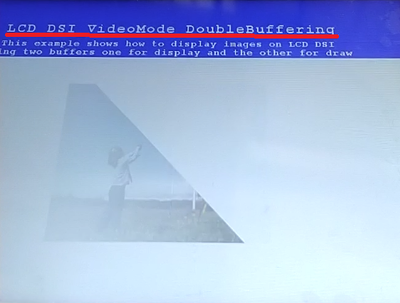

I have been trying to get the discovery board working in video mode with double buffering example working but have had no luck. I tried three different projects, the really old one from some release from two years ago, the 1.11.0 release, and the 1.11.1 release (a patch to the 1.11.0 release which seem to have added additional files relating to the display, i.e., nt35510.c, though I don't understand how this works since there's also the OTM8009A which I've copied from the previous release 1.11.1). None of these projects seem to give the expected behavior and frustratingly still results in tearing.
This is captured on my phone, what's shown below is played back at 960 FPS (I think, might be half of that). It seems to update the screen very quickly, faster than what my camera can capture, but bafflingly, does it in two diagonal halves.
If I understand the project correctly, once the buffer is prepared, the LTDC hardware is pointed to the address of the new buffer by a single change in pointer, and the LTDC runs continuously by scanning the buffer repeatedly and outputing the highspeed DSI data as it does not have a separate buffer. This change in pointer should be extremely fast.

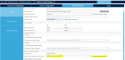

>>I also had no idea how to patch the 1.11.1 patch to CubeMX

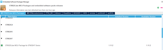

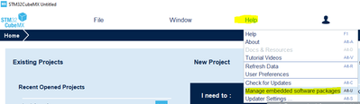

Could you please download and install the last version of STM32CubeMX, then click on help->Manage embedded software packages.
Then select STM32CUBE MCU package for STM32H7 Series version 1.11.2 and install it.

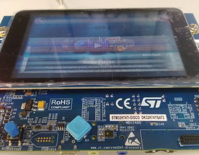

Probably, your information is outdated. I have exactly the same issue with the newest CUBE-H7 (1.11.2) and set define USE_LCD_CTRL_NT35510 (actually, that define is of no use as it appears only once in the project - only in stm32h747i_discovery_conf.h). The main board is D03, the display board is A09, bought recently at mouser (with completely empty flash i.e. without demo firmware).
Also there is an issue with TouchGFX demo (tried compiled hex file and built from source as well).
Seems like the board/screen weren't fully tested as well as the examples (see the red line on the first screenshot - I had to correct main.c in order to bring it on the screen).

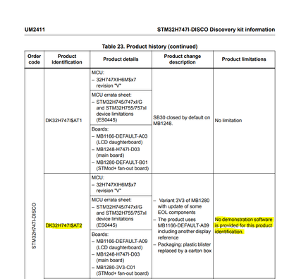

About the Demo, it is mentioned in UM2411, for DK32H747I$AT2 product identification, that No demonstration software is provided for this product identification.
