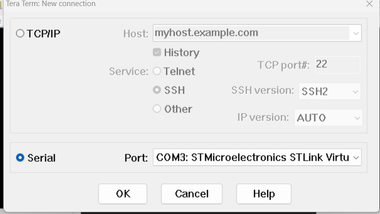

Below image shows the settings i made in Tera Term

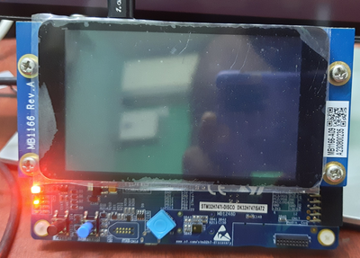

Below is the image of by board when executing the code.
