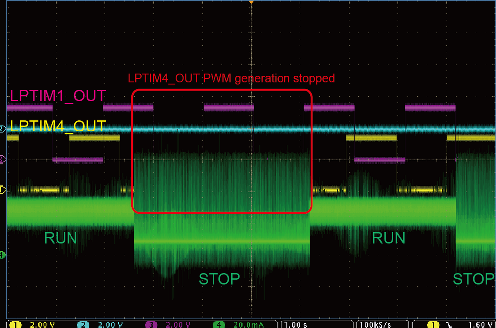

Hi everyone, we have a problem using LPTIM4 PWM output on STM32H747I-DISCO when system enters STOP mode.
In this project, I need two independent PWM outputs with fixed frequency to work, while system goes to STOP mode to save power. LPTIM1_OUT & LPTIM4_OUT are used for this purpose.
■ The issue is:
1.In RUN mode, both LPTIM PWM works as expected.
2. After system enters STOP mode, LPTIM1_OUT keeps PWM output, as expected.
But LPTIM4_OUT PWM stopped.
3. When system wakes up from STOP mode, LPTIM4 starts PWM generation again automatically. This behavior seems like normal timer, not low-power timer.
■ The waveform shown below helps to demonstrate the issue:
Red - LPTIM1_OUT
Yellow - LPTIM4_OUT
Green - MCU current consumption
■ Configuration codes are generated by STM32CubeIDE.
Some code excerpts:

2021-02-20 12:07 AM
Sorry, this issue has been fixed after adding these two lines in LPTIM4_Init:
__HAL_RCC_LPTIM4_CLKAM_ENABLE();
__HAL_RCC_LPTIM4_CLK_SLEEP_ENABLE();
This requirement is described in RM0399, P.408:
"In order for the LPTIMER to operate with lse_ck or lsi_ck when the circuit is in STOP mode, the user application has to select the lsi_ck or lse_ck input via LPTIMxSEL fields, and set bit LPTIMxAMEN and LPTIMxLPEN to '1'."
** LPTIMxLPEN is enabled by default, while 'LPTIM1AMEN' does not exist since it is not located in D3 domain.
