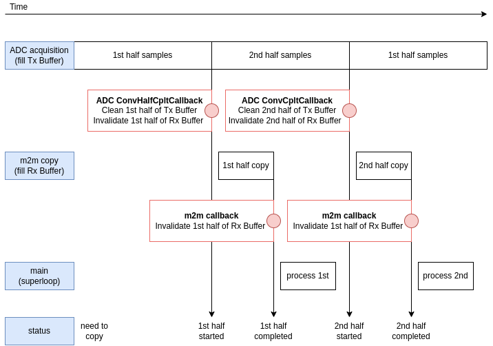

2022-09-10 2:58 AM
@Piranha Thanks for the guidance.
Here's a diagram of what I implemented so far, hope that is clear.
(edit: spotted a typo, the 2° m2m callback invalidates the 2nd half)
At the moment I can see that the m2m callback is never called.

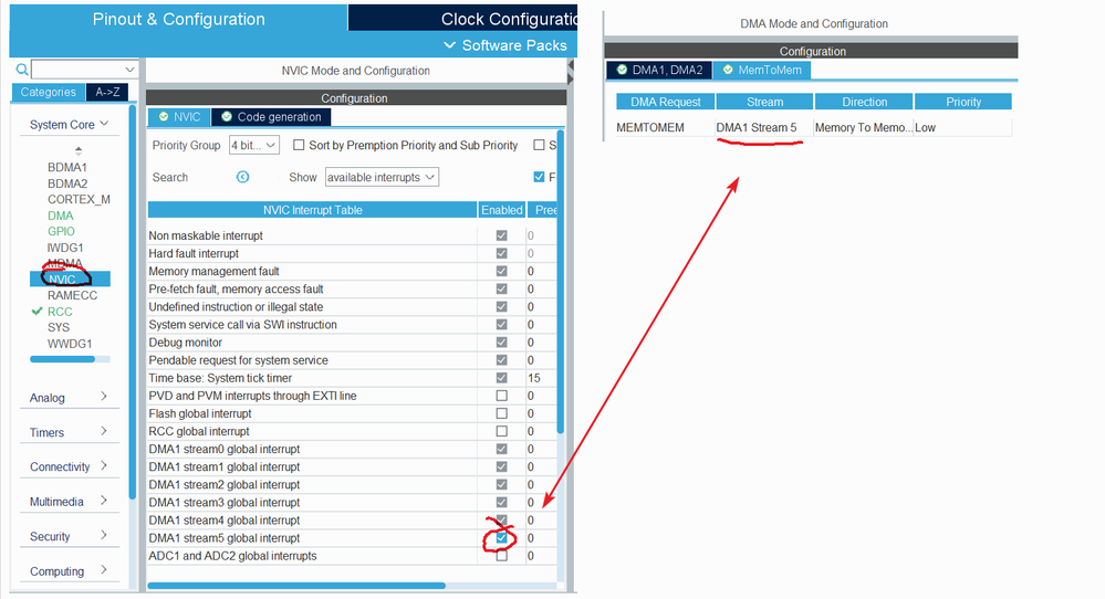

2022-09-10 7:20 AM
Make sure that MEM2MEM's "dma 2 stream 0" global interrupt is enabled. In my case it was "dma 1 stream 5 global interrupt":
