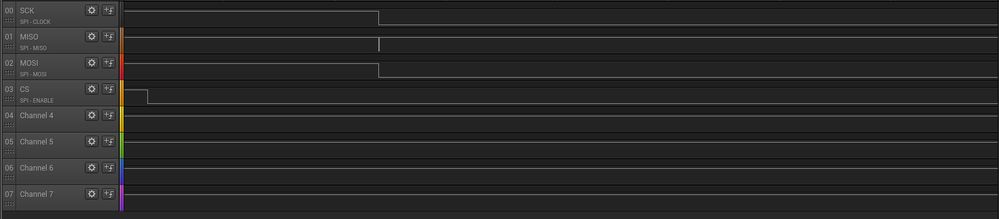

I am trying to implement SPI on nucleoH745ZI-Q without HAL or any kind of driver, I wrote my own registers pointers and functions like digitalWrite, pinMode or printf. I set up RCC, GPIO and SPI registers (all set, checked with debugger). But I can't get it work. I tried non-interrupt method (sending all data in loop - commented section) - with no luck. Then I tried interrupt method, I literally copied config from STM32CubeH7 Examples (checked registers with debugger and put it in my code), with no luck again. Always there is no sign of life on lines.
What am I doing bad?

}Analyzer Capture

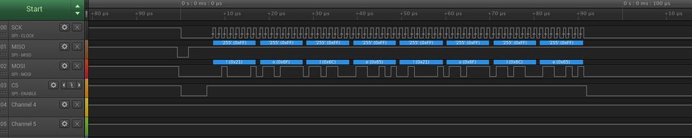

EDIT:
Finally i was able to get it work. First of all On my lovely nucleo board SPI_CS are marked incorrectly (PD14 instead of PA4) so there was first mstake. What i've done is I rewrote all configuration from scratch and then it worked. I think that error was accessing TXDR by 8bit - 32bits works now. I changed also Frame size. Anyway There is part of my new code fell free to use it if You like.

}Analyzer Capture:
