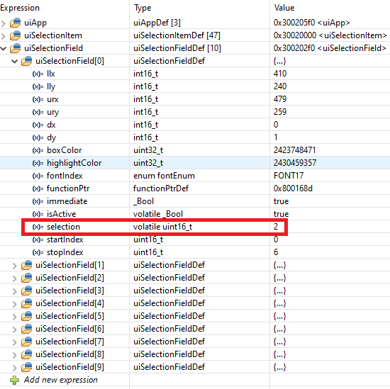

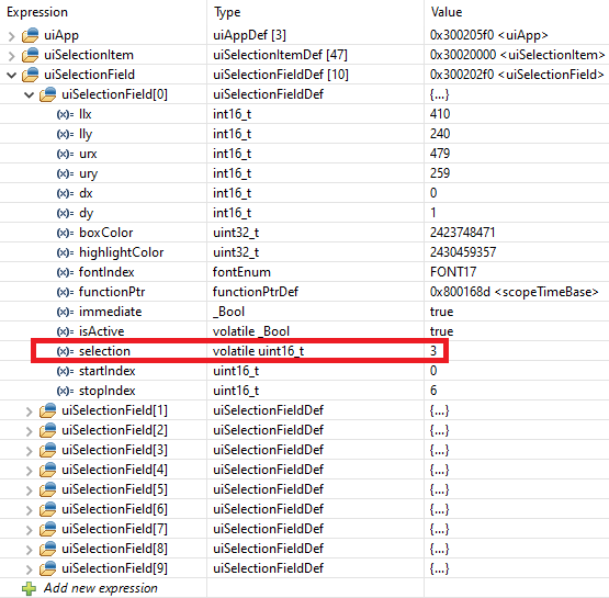

In debug mode, I see the following on CM7:
At the same time I see the following on CM4:
How is this possible if I have turned cacheability off?

Thanks for your reply. I physically store on CM7 what's shown in the first snapshot: value 3 in selection. So that one is correct. The one visible on CM4 is not correct. Why would I need to clean the DCache if caching is turned off? I think the MMU is working because the other memory areas for which I have turned off caching are working as expected (I know this because if I use caching, my other code is no more working). MPU_REGION_NUMBER0 says it's 0.
