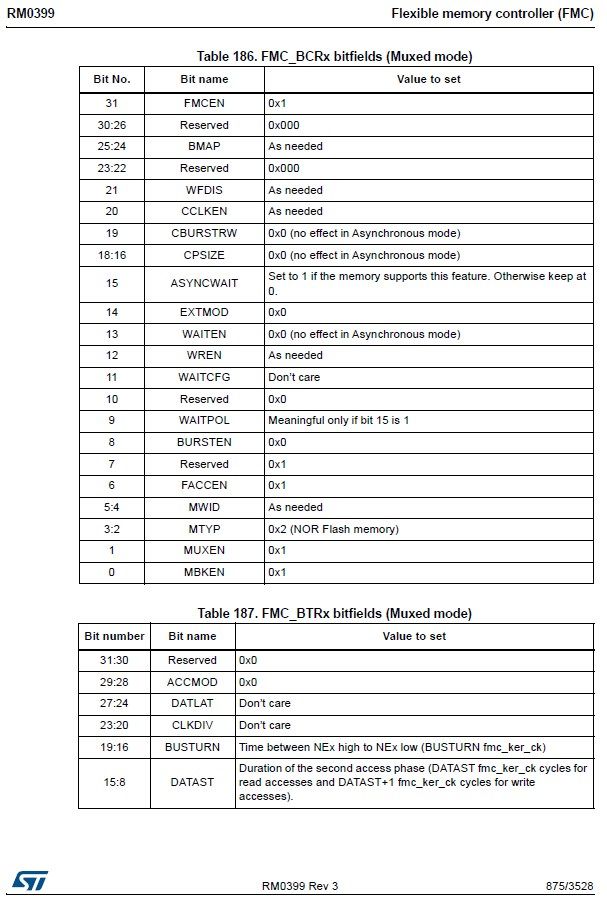

I'm using a STM32H745, that shall access an external NOR flash with the timing recommended by ST at the reference manual RM0399 on page 875. I did exactly reproduce this timing setting, but no access will be generated on the FMC pins.
When I change one single bit in this configuration (bit 8 = BURSTEN set to 1) the access works, but of course as BURST access. My intention is a non-burst access.
However, that proves that all other settings are basically ok, including pin configuration, providing clock to the FMC and generating read/write access to the FMC bank 1.

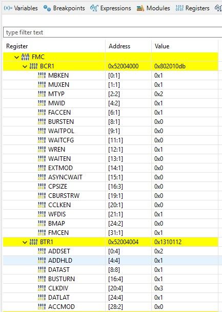

The issue can be reproduced on two ways:
First via debugger.
After configuring the pins and switching the FMC clock on, set the register BCR1 and BTR1 and generate access via memory browser.
Second with the following code:

}My questions:
Asynchronous access to NOR should work in non-burst mode as well as in burst mode.
Why does the non-burst example from ST not work?
How can a non-burst access achieved?

2021-08-24 9:25 AM
I have now switched on the MPU and configured the NOR-memory space as device.
The BURST read and write access is working perfect, but when configuring the bank for non-burst (bit 8 = BURSTEN set to 0) no access happens.
The MPU is configured according to the NOR example FMC_NOR for STM32H743 from CubeIDE. I copied the MPU initialising sequence from this project:
