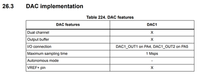

Please refer to the reference manual DAC implementation section of the correspondent product:

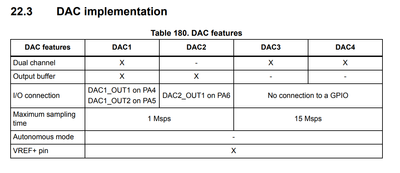

For example STM32G4 has 4 DACs:

There is only one DAC with two channels on this product in the datasheet:

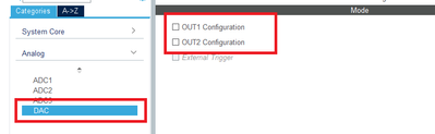

In CubeMx:

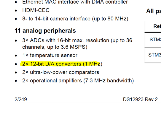

I'm a bit confused as everywhere has stated two DAC:
So, there is error in datasheet? Even product selector claims that there are two DACs. Is there any model of STM32H7 family, which actually has dual DAC?

STM32H745 and STM32H743 have the same DAC implementation. So you have one DAC instance with two channels (DAC1_OUT1/DAC1_OUT2).

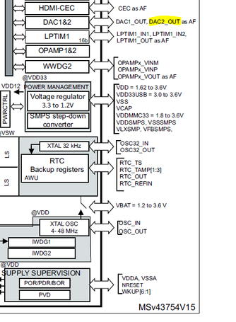

But indeed there is an issue in the second screenshot DAC2_OUT needs to be DAC1_OUT2 and DAC1_OUT has '1' is missing.
