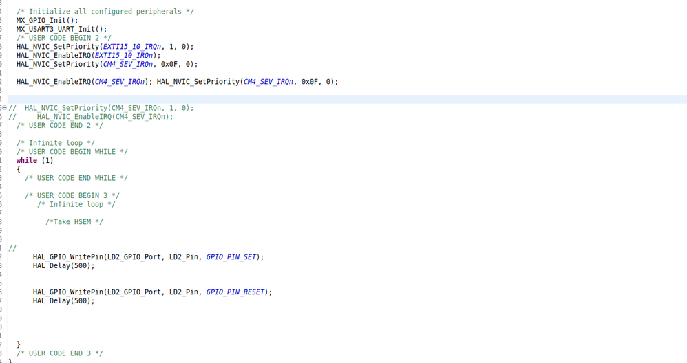

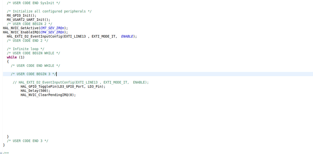

Hey i don't want to use any memory , I just want to send any type of interrupt from CM7 to CM4 without using any type of memory . I used CM7 send interrupt to CM4 this and add
/* Enable and set EXTI lines 15 to 10 Interrupt to the lowest priority */
HAL_NVIC_SetPriority(EXTI15_10_IRQn, 2, 0);
HAL_NVIC_EnableIRQ(EXTI15_10_IRQn);
this in main.c of cm7 and add
/* Configure the second CPU (CM4) EXTI line for IT*/
HAL_EXTI_D2_EventInputConfig(EXTI_LINE13 , EXTI_MODE_IT, ENABLE);
this in main.c of cm4 i attached the code image with it please go through it .
I just dont able to undarstand how its actually works. please help with same.
