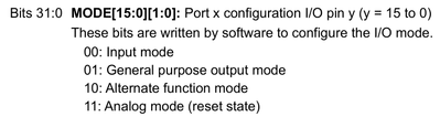

Since VBUS sensing is defined as additional function, it should be left at its default state (analog mode). So, you should configure PA9 as an input with no pull-up or pull-down resistors, and ensure it is in analog mode.

> Since VBUS sensing is defined as additional function, it should be left at its default state (analog floating input).
Is this documented anywhere? Where? I've looked, maybe I've missed it.

Thanks. It should probably be changed to say
... default state (analog), not as alternate....
Since input mode is different than analog mode and saying "floating input" to mean "analog" is misleading.

Apologies for the confusion @TDK. I forgot about this. For STM32H743, as per RM0433, the VBUS sense pin should remain in its default analog mode. In contrast, for STM32F411, the default state is input mode. The pin should be left unconfigured to allow sensing, as additional functions are directly managed through peripheral registers and should remain at their reset values.
