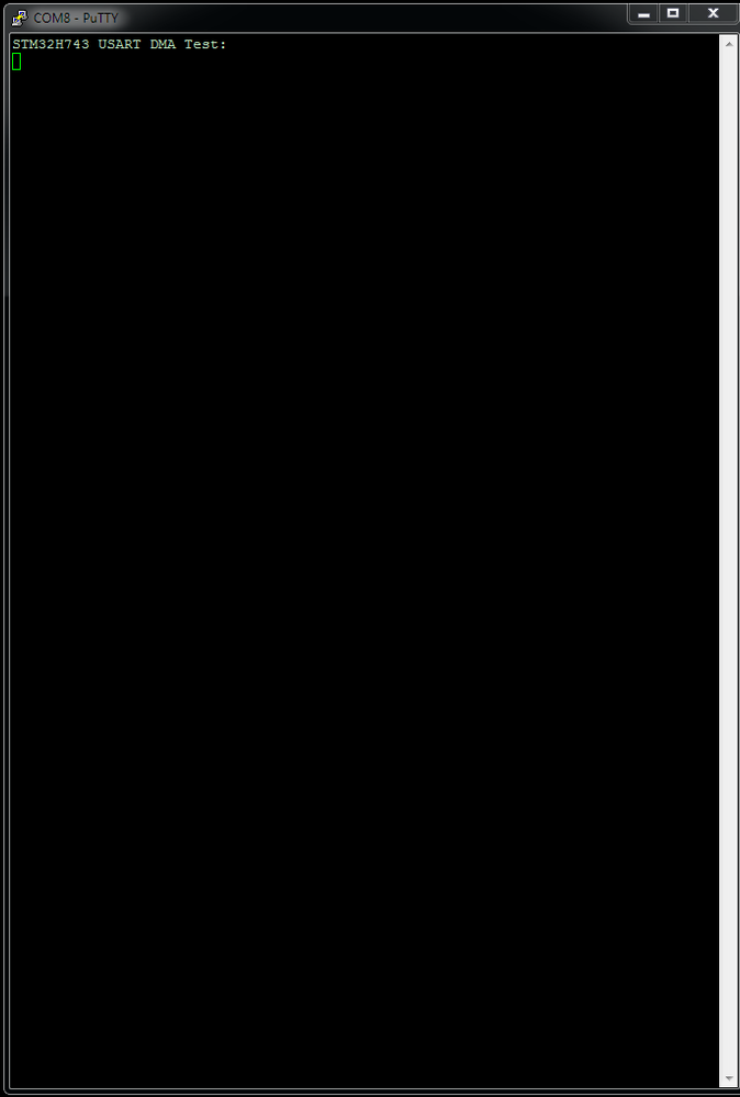

Can someone please help ?
Has someone got USART Peripheral with DMA transfers working on the STM32H743ZI2 ?
I have been trying to get DMA transfers to work on the H743. The DMA stalls after the very first DMA transfer and stays there itself.
Searching through the Erratum, found that USART peripheral DMA issue. It suggests to set bit 20 of DMA_SxCR register as a fix.
Did try the same, but had no success. Is there anything else that needs to be done to fix the situation ?
Attached screenshot of the UART3 (ST Link VCP) output.
Inlined minimalist code, which I have been trying.
Any thoughts ?

2020-07-05 10:37 AM
I don't see you configure the DMAMUX anywhere. Should be a call to LL_DMAMUX_SetRequestID to connect the dma stream to the peripheral.
Nevermind, looks like LL_DMA_SetPeriphRequest does the same thing (so why are there different function that do the same thing?)
The more I look at LL code, the less I like it even compared to HAL. I like the idea in theory but in practice just means you need to learn LL language as well as register language.
In any case, I do have this working on the H7 but can't spot what is different with our codes.

2020-07-05 1:06 PM
I understand now, why it did not work.
EnablePeriphDMA() was set too early, probably the rest of the DMA was set incorrectly.
moving it down, fixed the issue.
Maybe the 2 functions can be included in a future CubeH7 package, so that these 2 LL functions need not be carried around ?
The Stream DMA enable for the USART peripheral does not seem to be a bug at all. The way it is described makes it sound a bit hopeless, but is quite harmless.
