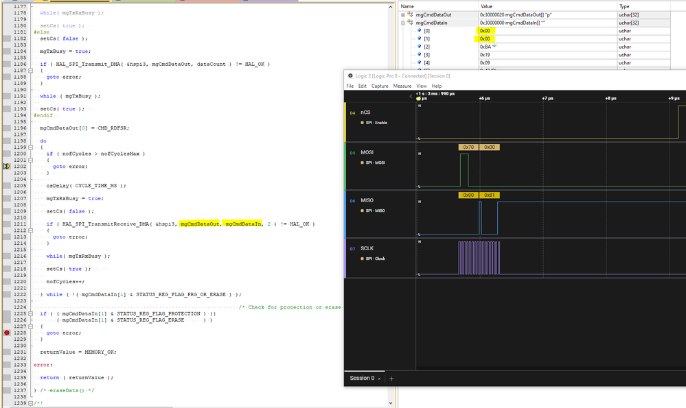

The Flash (MT25QL256ABA) is connectd to the STM32H743ZI (Nucleo) via SPI_3 and DMA. Send and Receive buffer are part of the SRAM3 area. There is no cache enabled.
To erase the flash the following procedure is done:
If the status register changes from 0x81 ot 0x01 the erase is done. I see that change with the logic analyzer but the receive buffer is not updated (no coherent data).
If I replace the HAL_SPI_Transmit_DMA() at step 1 and 2 the receive buffer is coherent to the datat measured by the logic analyzer.
Any idea?
