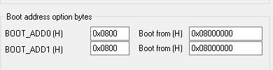

Hi, I fixed the issue!
I don't know why but during fw update using UART the "BOOT ADDRESS OPTION BYTE" area has been changed, I put the original configuration (see picture) and board started working.
2 questions:
A) How is it possible to change this area? Can it be corrupted during option byte writing operation or flash writing operation? I want to understand how it could have happened in order to fix the issue and avoid problems on the field.
B) Why a a "flash erase" (using ST-Link) is not able to solve the problem?
Thanks a lot Denis
