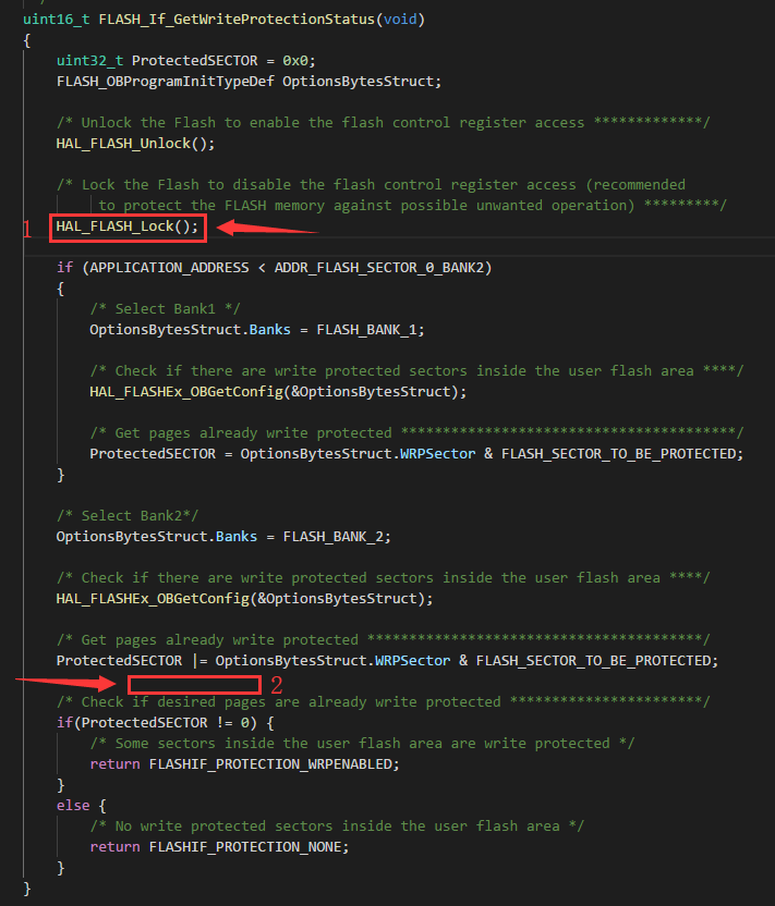

X:\STMicroelectronics\STM32Cube\Repository\STM32Cube_FW_H7_V1.2.0\Projects\STM32H743I_EVAL\Applications\IAP\IAP_Main
Isn't function HAL_FLASH_Lock() supposed to be in position 2?

Thank you for pointing this out. I was wondering why after the erase function call, the memory was not erased. I move the Lock function down to:
and now the flash erase works.

AHHHH!
uint16_t FLASH_If_GetWriteProtectionStatus(void)
uint32_t ProtectedSECTOR = 0x0;
FLASH_OBProgramInitTypeDef OptionsBytesStruct;
/* Unlock the Flash to enable the flash control register access *************/
HAL_FLASH_Unlock();
// /* Lock the Flash to disable the flash control register access (recommended
// to protect the FLASH memory against possible unwanted operation) *********/
// HAL_FLASH_Lock();
if (APPLICATION_ADDRESS < ADDR_FLASH_SECTOR_0_BANK2)
/* Select Bank1 */
OptionsBytesStruct.Banks = FLASH_BANK_1;
/* Check if there are write protected sectors inside the user flash area ****/
HAL_FLASHEx_OBGetConfig(&OptionsBytesStruct);
/* Get pages already write protected ****************************************/
ProtectedSECTOR = OptionsBytesStruct.WRPSector & FLASH_SECTOR_TO_BE_PROTECTED;
/* Select Bank2*/
OptionsBytesStruct.Banks = FLASH_BANK_2;
ProtectedSECTOR |= OptionsBytesStruct.WRPSector & FLASH_SECTOR_TO_BE_PROTECTED;
HAL_FLASH_Lock();
/* Check if desired pages are already write protected ***********************/
if(ProtectedSECTOR != 0)
/* Some sectors inside the user flash area are write protected */
return FLASHIF_PROTECTION_WRPENABLED;
else
/* No write protected sectors inside the user flash area */
return FLASHIF_PROTECTION_NONE;
Someday I figure out how you guys are doing that.
HAL_FLASH_Unlock();
/* Select Bank1 */
/* Select Bank2*/
HAL_FLASH_Lock();
else
