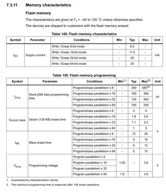

I believe your code has a Watchdog activated and the period time is not enough for the flash sector erase or may be a bit long enough timeout to allow the flash sector taking the maximum delay . Indeed based on each device a software should take into consideration the maximum value we put in datasheet and not typical . This may explain the behavior as changing the “Range” is just changing the “parallalism” : 0 corresponds to 8-bits , and 4 corresponds to 64-bits . Here are the timings
You can see as example Range3 corresponds to x32 that means typical parts may finalise erase of 128KB sector within 1.1 seconds , but other may last 2,2 seconds . Increasing the Range4 will shorten that time and Range2 ( 16-bits) will increase it . power consumption you can see in table 149 will have an opposite dynamic. Hope it helps you .
