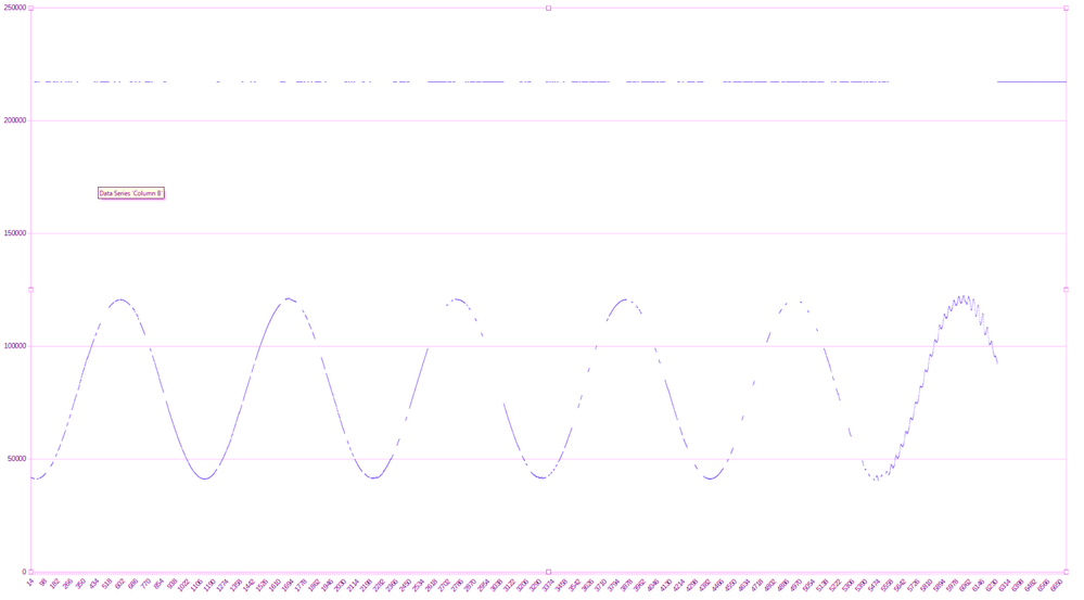

I have a set up where I'm reading from ADC1 via DMA1 S0 into a circular buffer in RAM2. The problem is that it is randomly skipping samples. I initialise the buffer to a known bad value so I can see that some addresses in the buffer are not being overwritten. If I feed a sine into the input, the picture at the bottom of this post is what I get out. The flat line at the top is the pre-initialised data. The gaps in the sine wave are not in the same place each time. The gaps are in clusters of 8 samples or multiples of 8 samples.

2021-10-18 5:50 PM
2021-10-18 5:12 PM
Could this be caused by a cache problem?

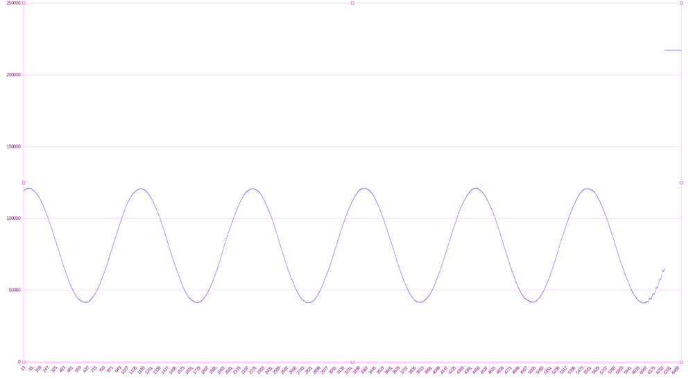

2021-10-18 5:50 PM
I disabled the dcache and this is what I see.
