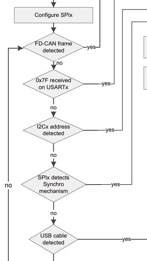

Need check and read better
order for detection if other interface is marked as detected SPI ...
Check too schematics and table 107 pinout usw.

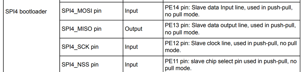

Not sure what you are intending to indicate. I believe the diagram you sent is for the bootloader itself to decide which interface to use for bootload. In our case, we want the bootloader to use SPI (SPI4 in the case of out STM32H743). However, we are not seeing any activity on the MISO of our SPI4. Hence, basically indicating Bootloader did not detect the sync byte 0x5A coming from the primary micro (from MOSI) to reply with 0xA5 on MISO. Therefore, it is more than likely trying to bootload on another interface.
Please note that we have followed the recommendations on Table 108 of AN2606 and in particular PA11 and PB15 are pulled HIGH.along with stack pointer being lower than RAM end @ - 16 bytes.
BTW, except for SPI4, which we need for the Bootloader communication and is configured as recommended on Table 107 of AN2606, I have even tried to manually stop all the other used interfaces (I2C1, I2C2, I2C4, SPI2, USART2) on our STM32H design and changed all the pins for those interfaces to GPIO and at quiet state prior to the bootloader jump. Note that I know that the ST Bootloader is probably reconfiguring the pins for its needs, nevertheless, I have even done that prior to the bootloader jump and still ST's bootloader is not communicating on the SPI4.

Read AN2606 better, only this pins is SPI4 for bootloader
and i send you diagram for you see SPI is on end check , then if detected is any other first ...

Thanks for following up. Yes, we are using PE11 for SPI4_SNN, PE12 for SPI4_SCK, PE13 for SPI4_MISO, and PE14 for SPI4_MOSI. Also as mentioned before, we have followed the ST recommendations on Table 108 of AN2606 to "supposedly" avoid bootloader to choose another interface other than SPI4.
