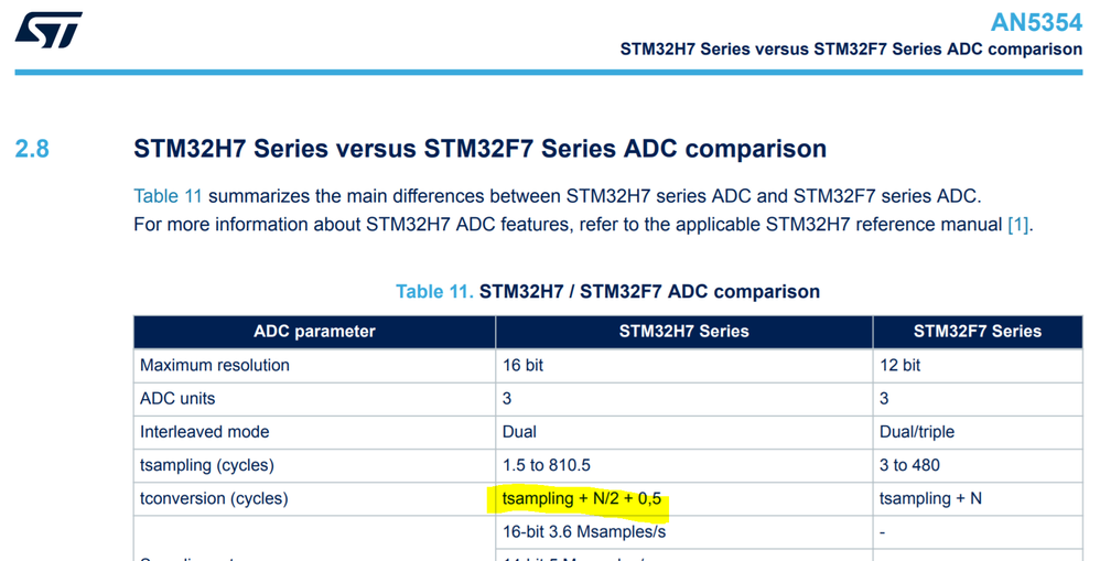

> STM32H743
> how can i calculate the ADC total conversion time?
ADCs are independent. Conversion time is listed in the reference manual (I think) as well as here:
For 8.5sec sampling at 16 bits, conversion takes 8.5 + 16/2 + 0.5 = 17 cycles.
At 7MHz, that's 2.42 us.
