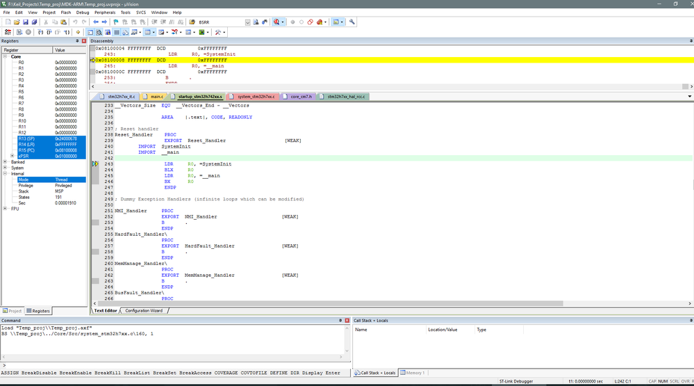

2021-03-22 3:26 AM
Well I have looked through the dissassembly and it seems that nothing is written to the flash.
Could it be due to StLink V2 do not support STM32H7 cores?
2021-03-22 5:49 AM
The code does seem oddly placed in memory. It is at the 1MB deep point, and the vector table is some place else.
You'd probably want to review the memory model employed in the project, the scatter file (.SCT) and the map file (.MAP)
Make sure the check box item to download before debug is checked.
If using a debug script, make sure that LOADs the file or you flash it manually prior to debugging
