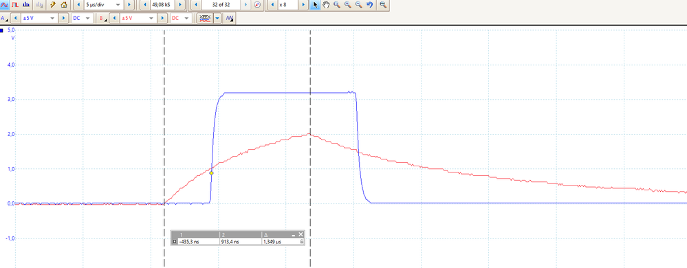

I tried toggling the pins manually with pulse width around 1.4 us and curious thing is that while pin PC2_C is working well enough, PC3_C is so slow that its value does not even reach 3.3V, see picture:
You can see that PC2_C (blue one) has rise time about 100 ns, PC3_C (red one) has more than 1.3 us.

On Nucleo-H723ZG, Rev. Z, (PC2 and PC3 not bonded out as well), VDD 3.3V, both PC2_C and PC3_C look quite ok, taking into account a rather high output impedance of approx. 300 Ohms. From top to bottom: PA03, PC03_C and PC02_C, configured as push-pull output with pull-up enabled, all three open, only probes attached. SYSCFGEN set to 1 in RCC_C1_APB4ENR, SYSCFG_PMCR is 0x03000000 (PC3SO and PC2SO both 0)

thanks for your support. It did not occur to me to try it on the Nucleo-H723ZG even though we have it here. So now I tried it as you did and I agree, that on this board this problem is not present.
