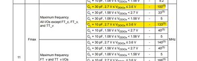

We are having trouble getting tracing to work with our target at full clock speed and would like to understand why, we have an application running on STM32U575 @ 160MHz CPU clock, we also connected the J-Tracer to it using a connector glued next to the uC and short wires (~10mm) to PE2 ... PE6 (pins 1 to 5 on the LQFP100), the GPIO pins are all configured (using a JLinkScript) as AF and at maximum speed, and from what we understood on the documentation (Arm trace technical specification - SEGGER Wiki) the trace clock and trace data operate at half the CPU speed, I checked the ST datasheet and the GPIOs we are using should be good up to 100MHz, so in theory the trace should be possible with the CPU running at 160MHz and outputting trace data @ 80MHz, or?

I tried to run H75x at 400MHz CPU / 100MHz trace clock using Keil µVision but had no luck, although the signals fulfil the timing specifications.
