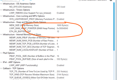

we have test many configurations for memory position for Rx Tx and LwiRamHeap
In certain conditions hi dont remember its , I succeeded to ping my board , but
after several try of ping we have hardware fault
We think that it was bad configuration for Rx Tx and the heap description .
Can you help me to fit the good comfiguration

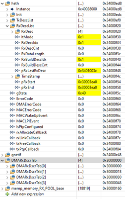

Now the stack is running
When we try to ping the board the response is OK
C:\Users>ping 192.0.1.218 -t
Envoi d’une requête 'Ping' 192.0.1.218 avec 32 octets de données :
Réponse de 192.0.1.218 : octets=32 temps<1ms TTL=255
but we have DMAErrorCode=0x4080 ? why ?
