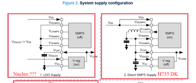

Not so sure about this, the SMPS needs some feedback signal, and that's VFBSMPS.
So try with the 0R.
That might explain why you measure something close to input voltage, your "VDD" should be something around 1.1V (check datasheet).
This pic from AN5419 about H7 power (red notes by me):
2025-02-18 6:58 PM
So my first board tried number 1 and was shorting on the VDDSMPS pins.
The zero ohm there lets me put it into type 2, i have another that lets me go into type 3.
No matter this config the VFBSMPS is connected correctly
