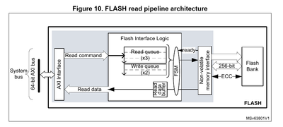

The AXI bus is clocked at core speed (afaik) , so 1 clk -> 1 32b transfer . (maximum- if "nobody" else requesting the bus, maybe cpu or other DMA...)
* how many 4-byte f32 transfers can I expect per m7 core clock tick using DMA from flash to dram
Depends on size of transfer, flash is accessed 256b wide, at 3WS (4 clks) at max. speed (550MHz);
so 4 clks for first , then 1 clk next 7 x 32b words.
see rm.
If D-cache enabled and cache line loaded, then maybe without any waitstates .
But anyway : try a simple test, then you know.
