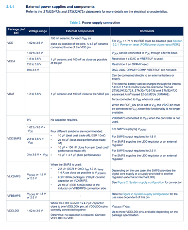

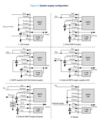

Please take a look at AN5419 figure 2, table 2. and table 30 in RM0468 may help you for power supply connection.
By configuring the SMPS step-down converter and LDO voltage regulator, the supply configurations shown in the below figure are supported for the VCORE core domain and an external supply.

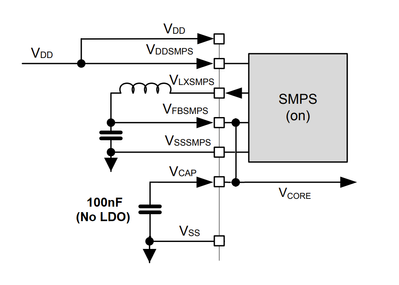

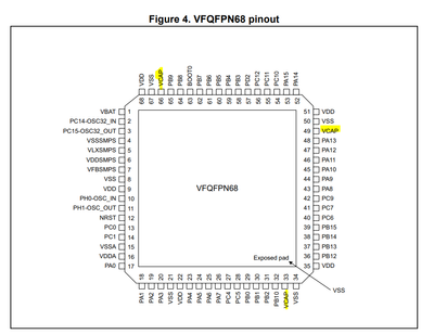

2024-10-10 6:38 AM
Hi Kaouthar,
Thanks for the quick response!
A small correction, the VQFPN68 package does have a VCAP pin, the VDDLDO is not available.
Just to make sure I understood you, the configuration for VQFPN68 should look something like this?
Thanks again,
Nir

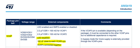

2024-10-10 6:57 AM
Hi @NirAlon ,
Thank you for updating post and for your comment.
Yes , you are right, the VCAP pin is available in VQFPN68 package.
It is correct, when LDO is disabled 100 nF close to each VCAPx pin.
