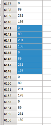

At the begins of the first valid buffer the USB data and the bus capture are aligned:

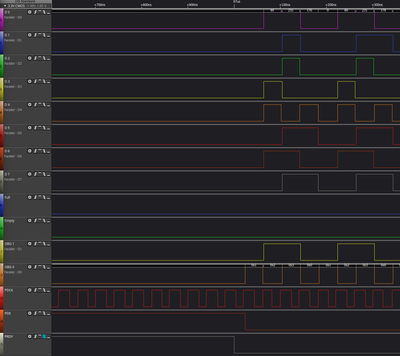

But at the end of the first buffer there is a loss of 8*sizeof(uint32_t) => 32 byte.

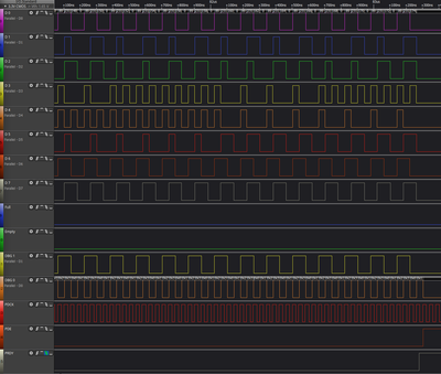

We can see on the capture that those missing byte are transferred through the bus and dropped and the begins of the next packet align.
While looking at the full packet length it appears why we have that results. The total valid time of PRDY signal is 83.28us, knowing the clock runs at 25MHz (period of 40ns) it means there are 2082 cycle of PRDY valid, removing the first cycle (where PDE is not asserted) and the last cycle discarded (I repeat this one later) it makes 2080 cycle. If we take an expected length of 2048 cycle and add the 32 missing byte it reaches 2080 cycle.

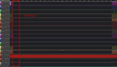

For now I added a workaround allowing me to continue working on this project.
Deasserting data enable doesn't help, PRDY is still enabled no matter what. So I basically send garbage and stale my FIFO as soon as PRDY is asserted for more than 2048 cycle and until next PRDY cycling.

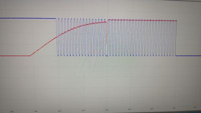

2023-10-09 9:08 PM

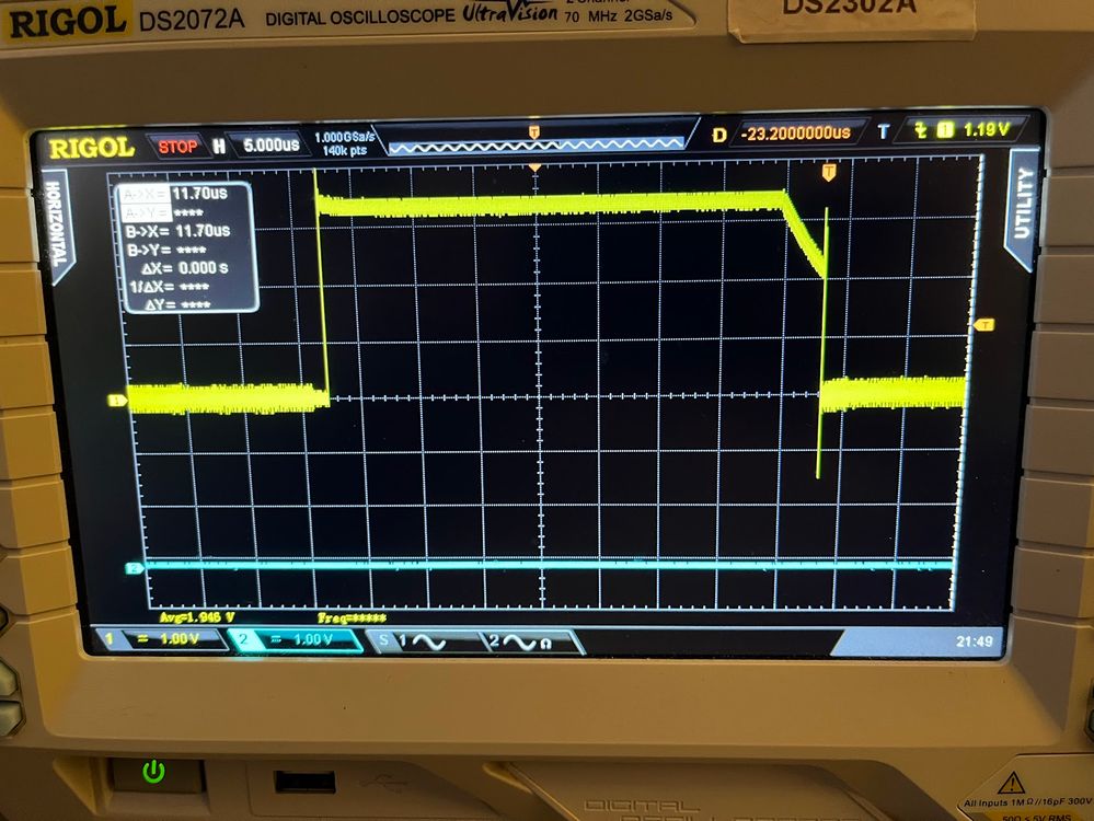

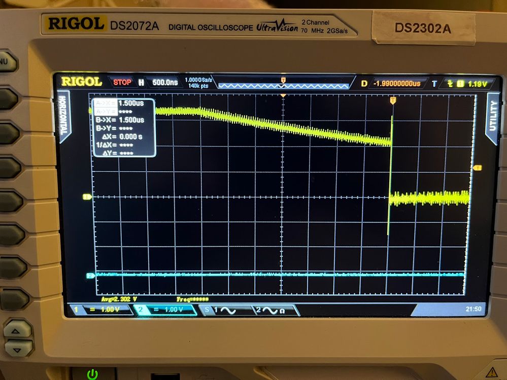

I also saw weird spurious content on my RDY signal in addition to the FIFO bug!
I stuck a picture of the worst case behavior that I captured. In my case it was due to a weak pullup on the output pin of the ICE40 FPGA I had on the other end of the interface. When the HAL_ library disables the interface and blanks the FIFO, it also releases drive on the IO pin allowing it to float. I solved this by disabling the pullup on the ICE40 output, and enabling a pulldown on the STM32 RDY input.
You can prevent the FIFO bug too, by simply commenting out the "HAL_PSSI_DISABLE(hpssi);" at the top of the read function. Does this fix go away every time you regenerate the code? yes. Should I open a issue against the github for the HAL_ library? probably. Has this allowed me to get rock solid PSSI operation out of my part? Also yes.

2023-10-10 12:32 AM
I'm using active low signal but got exactly same weird problem I captured.
On see this one you can see DRDY going crazy and causing the trigger of a DE too early.
In my system I also use an ice40 so I force the pull-up to avoid DRDY being released too early. It fixes a lot but still I have glitches sometime making it unreliable. If you datastream must be stable for long time I suggest you test it deeply because sometime it can run for hours before starting to glitch.
I'll do some more testing, but my confidence in the PSSI bus is really low now.
