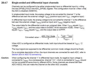

2024-05-14 9:22 AM
Need also to check if you're in differential / or single ended mode vs your HW:
2024-05-14 2:47 PM
Its single ended mode.
