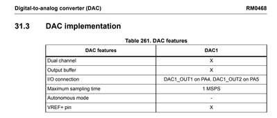

STM32H7 has one DAC instance DAC1 with two output channels on DAC1_OUT1 / DAC1_OUT2.
From the reference manual:
Almost the same same question asked in this thread.
