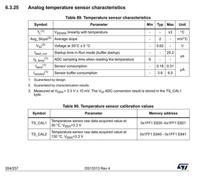

> How does the external reference voltage of 3.0 V affect the temperature sensor?
In the same way as for any other ADC measurement. What you want to measure is the temperature sensor's voltage; for that you take ADC reading and then convert it into voltage by using the reference voltage.
Also, if you want to use the constants stored in system memory, for 'H733 they have been taken for VREF=3.3V (the DS partially incorrectly says VDDA=3.3V), so you have to take that into consideration when using them in calculation, too.

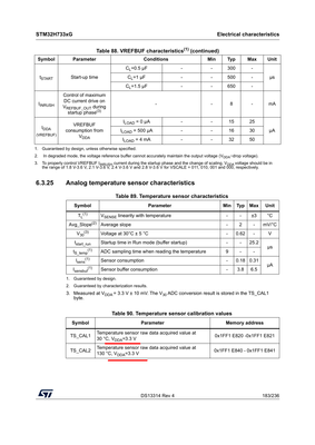

The most common pitfall is failure to calibrate the ADC before use, as the RM requires. The other is failure to observe the required settling and sampling times.
A list of possible problems with temperature sensor here.
If you've followed that and no improvement, post concrete numbers (ADC settings/registers content, related frequencies, readouts, values of calibration constants).

2024-06-27 3:20 AM
There's still the open question:
I can't find anything in the datasheet or RM, although it makes sense that the result has to be multiplied by 3.0/3.3.
But maybe there are other effects, like the TS cal values stored in flash don't make sense anymore?
2024-06-27 3:35 AM

2024-06-27 5:39 AM - edited 2024-06-27 5:39 AM
@waclawek.jan 's document showed me the solution:
yes, it is a simple correction factor 3.0 (used Vref) / 3.3 (Vref at factory calibration), but it has to be applied to the raw ADC output from the temperature sensor.
BIG THANKS again to Jan!
